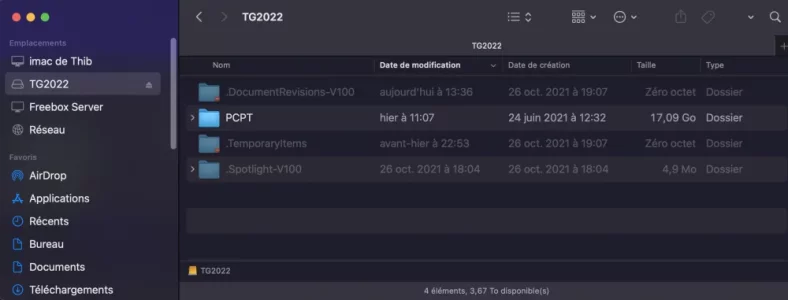

Et hier, catastrophe, le dossier VIDEO (à la racine) de sauvegarde n'apparait plus sur le disque !!!
L'autre dossier (PCPT) et ses sous dossiers sont pourtant toujours accessibles...

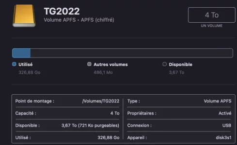

L'espace est toujours bien occupé (3,67 / 4 to dispo ) donc j'imagine que les vidéos sont toujours là :oops: mais où ???

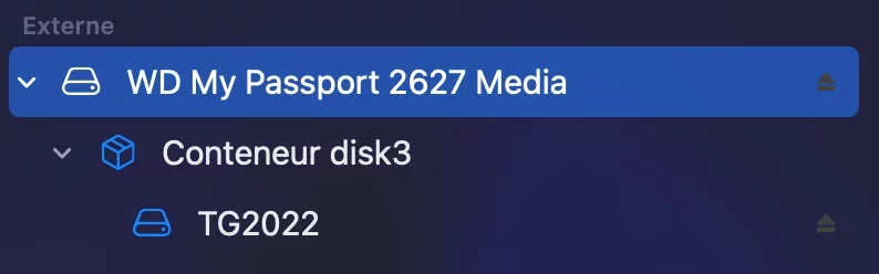

Du côté utilitaire de disque, j'ai tenté des SOS.

Exécution de S.O.S. sur « Conteneur disk3 »

error: drec_key object (oid 0x13): invalid hash (0x0, expected 0x3151c9) of name (0.indexPositionTable)
error: drec_key object (oid 0x13): invalid hash (0x0, expected 0x167d9b) of name (0.indexPositions)
error: drec_key object (oid 0x13): invalid hash (0x0, expected 0x85513) of name (0.indexPostings)
error: drec_key object (oid 0x13): invalid hash (0x0, expected 0x3ac330) of name (0.indexTermIds)
error: drec_key object (oid 0x13): invalid hash (0x0, expected 0xfcd1f) of name (0.indexUpdates)
error: drec_key object (oid 0x13): invalid hash (0x0, expected 0xb438) of name (0.shadowIndexArrays)
error: drec_key object (oid 0x13): invalid hash (0x0, expected 0xf1784) of name (0.shadowIndexCompactDirectory)
error: drec_key object (oid 0x13): invalid hash (0x0, expected 0x2308df) of name (0.shadowIndexDirectory)
error: drec_key object (oid 0x13): invalid hash (0x0, expected 0x36f7ac) of name (0.shadowIndexGroups)
error: drec_key object (oid 0x13): invalid hash (0x0, expected 0x25a9c) of name (0.shadowIndexHead)
error: drec_key object (oid 0x13): invalid hash (0x0, expected 0x1d50b7) of name (0.shadowIndexPositionTable)
error: drec_key object (oid 0x13): invalid hash (0x0, expected 0x6e792) of name (0.shadowIndexTermIds)
error: drec_key object (oid 0x13): invalid hash (0x0, expected 0x395c80) of name (Cab.created)
error: drec_key object (oid 0x13): invalid hash (0x0, expected 0xbad6d) of name (Cache)
error: drec_key object (oid 0x13): invalid hash (0x0, expected 0x324603) of name (Lion.created)
error: drec_key object (oid 0x13): invalid hash (0x0, expected 0x7d5a3) of name (dbStr-1.map.buckets)
error: drec_key object (oid 0x13): invalid hash (0x0, expected 0x3568ac) of name (dbStr-1.map.data)
error: drec_key object (oid 0x13): invalid hash (0x0, expected 0x8402b) of name (dbStr-1.map.header)
error: drec_key object (oid 0x13): invalid hash (0x0, expected 0x3570f9) of name (dbStr-1.map.offsets)
error: drec_key object (oid 0x13): invalid hash (0x0, expected 0x18beac) of name (dbStr-2.map.buckets)
error: drec_key object (oid 0x13): invalid hash (0x0, expected 0x192120) of name (dbStr-2.map.data)
error: drec_key object (oid 0x13): invalid hash (0x0, expected 0x336727) of name (dbStr-2.map.header)
error: drec_key object (oid 0x13): invalid hash (0x0, expected 0x2a1bf6) of name (dbStr-2.map.offsets)
error: drec_key object (oid 0x13): invalid hash (0x0, expected 0x364a06) of name (dbStr-3.map.buckets)
error: drec_key object (oid 0x13): invalid hash (0x0, expected 0x19340b) of name (dbStr-3.map.data)
error: drec_key object (oid 0x13): invalid hash (0x0, expected 0x1a7a23) of name (dbStr-3.map.header)
error: (oid 0x40f) apfs_root: btn: invalid o_oid (0x648)
error: (oid 0x40f) apfs_root: btn: invalid o_xid (0x387, expected 0x3b2)
L’arborescence fsroot n’est pas valide.
Le volume /dev/rdisk3s1 n’a pas pu être vérifié entièrement.
Le code de sortie de la vérification du système de fichiers est 0.
Rétablissement de l’état original : monté.
L’opération a été effectuée.
J'ai ensuite tenté un diskutil par le terminal :
imac-de-Thib:~ Tib$ diskutil repairVolume disk3
Started file system repair on disk3
Repairing storage system
Performing fsck_apfs -y -x /dev/disk2s2
warning: spaceman chunk 2694 free count 1025597 > block count 32768
warning: spaceman main free count 896771774 does not match sum of free counts 896794753
Checking the space manager free queue trees
warning: Unable to read apfs keylocker ranges: No such process
(... liste d'erreur identique à ci dessus )
fsroot tree is invalid
The volume /dev/disk2s2 could not be verified completely
Finished file system repair on disk3
