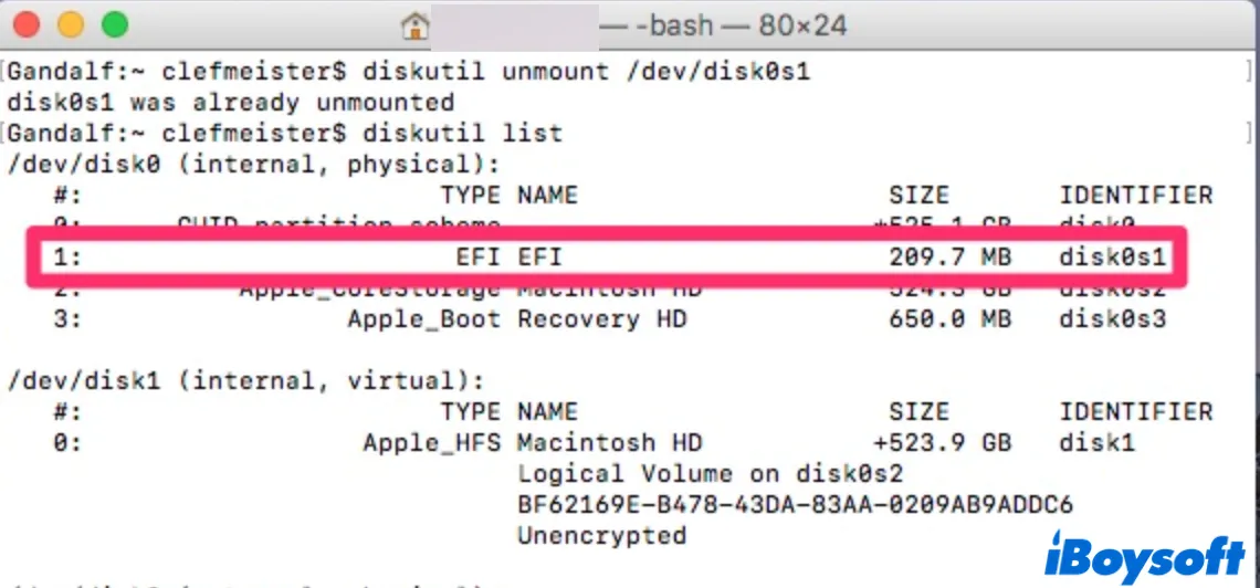

diskutil list
You should see a list of drives, including both internals and externals. Find the EFI partition on your start-up drive with the type name, EFI.
find EFI partition using Terminal
