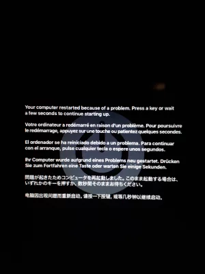

10.13 High Sierra impossible démarrage depuis l'installation avortée d'High sierra

@Coronaaustralis
Donc tu vas taper :
diskutil cs unlockVolume 7C036B04-8195-408C-A9DF-1E33A264812A
Là ton mot de passe te sera demandé et ne s'affiche pas lorsque tu le tapes.
Puis tu vas taper
ls -l /Volumes/"Macintosh HD"
et enfin
df -H

@Coronaaustralis
Donc tu vas taper :
Puis tu vas taper
et enfin
df -H
-bash-3.2# diskutil cs unlockVolume 7C036B04-8195-408C-A9DF-1E33A264812A
Passphrase:
Started CoreStorage operation
Logical Volume successfully unlocked
Logical Volume successfully attached as disk20
Logical Volume successfully mounted as /Volumes/Macintosh HD
Core Storage disk: disk20
Finished CoreStorage operation
-bash-3.2# ls-l/Volumes/"Macintosh HD"
-bash: ls-l/Volumes/Macintosh HD: No such file or directory
-bash-3.2# ls -l/Volumes/"Macintosh HD"
ls: illegal option -- /
usage: ls [-ABCFGHLOPRSTUWabcdefghiklmnopqrstuwx1] [file ...]
-bash-3.2# ls-l/Volume/"Macintosh HD"
-bash: ls-l/Volume/Macintosh HD: No such file or directory
-bash-3.2# df -H
Filesystem     Size   Used  Avail Capacity iused      ifree %iused  Mounted on
/dev/disk1s1   2.0G   1.3G   728M    64%   44922 4294922357    0%   /
devfs          203k   203k     0B   100%     688          0  100%   /dev
/dev/disk2     5.2M   1.5M   3.7M    29%      24 4294967255    0%   /private/var/log
/dev/disk3     524k   147k   377k    29%       4 4294967275    0%   /Volumes
/dev/disk4     524k   152k   373k    29%       8 4294967271    0%   /private/var/tmp
/dev/disk5     524k   160k   365k    31%      12 4294967267    0%   /private/var/run
/dev/disk6     2.1M   143k   2.0M     7%       2 4294967277    0%   /private/tmp
/dev/disk7     524k   143k   381k    28%       2 4294967277    0%   /System/Installation
/dev/disk8     524k   303k   221k    58%      21 4294967258    0%   /private/var/db
/dev/disk9      13M   2.7M   9.8M    22%      82 4294967197    0%   /private/var/folders
/dev/disk10    2.1M   2.1M     0B   100%     194 4294967085    0%   /private/var/root/Library
/dev/disk12    2.1M   348k   1.7M    17%      49 4294967230    0%   /private/var/root/Library/Containers
/dev/disk13    524k   172k   352k    33%       9 4294967270    0%   /Library/Preferences
/dev/disk14    524k   160k   365k    31%       5 4294967274    0%   /Library/Preferences/SystemConfiguration
/dev/disk15    1.0M   176k   872k    17%       5 4294967274    0%   /Library/Keychains
/dev/disk16    6.3M   176k   6.1M     3%       2 4294967277    0%   /private/var/tmp/RecoveryTemp
/dev/disk17    6.3M   176k   6.1M     3%       2 4294967277    0%   /private/var/tmp/OSISPredicateUpdateProductTemp
/dev/disk18    524k   143k   381k    28%       2 4294967277    0%   /private/var/tmp/InstallerCookies
/dev/disk19    2.1M   143k   2.0M     7%       2 4294967277    0%   /Library/Logs/DiagnosticReports
/dev/disk20    120G    51G    69G    43%  576763 4294390516    0%   /Volumes/Macintosh HD
-bash-3.2#
Je ne sais pas si j'ai tout bien fait, tu me diras...

Presque :
ls<espace>-l<espace>/Volumes/"Macintosh HD"
Et la question subsidiaire est : as-tu un disque externe dispo?

Presque :
-bash-3.2# ls -l /Volumes/"Macintosh HD"
total 56
-rw-rw-r--    1 root  admin   6148 Oct  6 10:48 .DS_Store
d--x--x--x    9 root  wheel    306 Nov  6 19:54 .DocumentRevisions-V100
-rw-r--r--    1 root  wheel    361 Nov 23 17:36 .IAProductInfo
drwxr-xr-x    2 root  admin     68 Oct 21  2016 .PKInstallSandboxManager
drwx------@   2 root  admin     68 Nov 15 23:05 .PKInstallSandboxManager-SystemSoftware
drwx------    5 root  wheel    170 Oct 21  2016 .Spotlight-V100
-rw-r--r--    1 root  wheel    881 Nov 23 17:36 .TALRestoreApps
drwx------  302 root  wheel  10268 Nov 23 17:36 .fseventsd
drwxr-xr-x@   2 root  wheel     68 Jul 30  2016 .vol
drwxr-xr-x@   2 root  wheel     68 Jul 30  2016 Network
drwxr-xr-x    8 root  wheel    272 Nov 23 17:44 Recovered Items
drwxr-xr-x    6 root  admin    204 Mar 16  2017 Users
drwxr-xr-x@   4 root  wheel    136 Nov 23 17:36 Volumes
drwxrwxr-t@   2 root  admin     68 Jul 30  2016 cores
dr-xr-xr-x@   2 root  wheel     68 Jul 30  2016 dev
lrwxr-xr-x@   1 root  wheel     11 Oct 21  2016 etc -> private/etc
dr-xr-xr-x@   2 root  wheel     68 Nov 27  2016 home
drwxr-xr-x@  16 501   staff    544 Nov 23 17:40 macOS Install Data
dr-xr-xr-x@   2 root  wheel     68 Nov 27  2016 net
drwxr-xr-x    3 root  wheel    102 Nov 23 17:43 private
lrwxr-xr-x@   1 root  wheel     11 Oct 21  2016 tmp -> private/tmp
lrwxr-xr-x@   1 root  wheel     11 Oct 21  2016 var -> private/var

Ok
Tes données sont là : 50 Go à sauvegarder pour ne pas prendre de risques, puis réinstallation.
Tu vas quand même tenter ceci :
diskutil repairVolume disk0s2
Puis redémarrer normalement et être très patiente si tu vois une barre qui ne progresse pas.
Sinon tu stoppes le Mac, achètes un disque externe usb3 500 Go ou 1 To et tu refais signe.
Parallèlement si tu as des connaissances qui ont un Mac, tu peux leur faire télécharger Sierra, mais ne pas lancer l'install et le laisser dans le dossier Applications
Ensuite tu peux créer ta clé bootable Sierra, il faut :
1) qu'elle ai un schéma de type GUID et une partition d'au moins 8 Go libre (utilitaire de disques/Effacer)
2) tu nommes cette partition CLE et tu la laisses connecté sur le Mac.
3) Dans le terminal(Applications/Utilitaires) tu tapes la commande :
sudo /Applications/Install\ macOS\ Sierra.app/Contents/Resources/createinstallmedia --volume /Volumes/CLE --applicationpath /Applications/Install\ macOS\ Sierra.app/ --nointeraction
Là le mot de passe administrateur du Mac sera demandé et ne s'affiche pas quand on le tape.
Au bout de 15 mn ta clé bootable sera prête. Il suffit d'appuyer sur ALT lors du boot pour démarrer dessus.
Mais tu ne l'utiliseras qu'après avoir sauvé tes données.

Donc là, à part fair "diskutil repair", je ne fais plus rien jusqu'à ce que j'ai un disque dur externe et que je sauvegarde tout? J'ai des connaissances qui ont des Mac mais j'ai bien peur que nos compétences informatiques soient équivalentes xD
Tu tentes le :
Puis tu redémarres normalement en laissant ton Mac branché sur le secteur.
Si tu voies une barre de progression qui semble figée, tu laisses ainsi, à la limite toute la nuit (sans veiller la bête ça va sans dire:D)
Si demain rien n'a évolué tu stoppes le Mac et tu te procures le disque et une clé usb et tu fais signe.
Pour la clé, c'est quand même pas très compliqué :
1) Télécharger Sierra
2) Ne pas l'installer
3) Via l'utilitaire de disque "Effacer" une clé USB de 8 Go et la nommer CLE
4) Copier/coller dans le terminal la 2ème ligne en gras du post #74 ci-dessus puis patienter 10 Mn.

Okay, je fais tout ça ! Et je reviens demain matin ;)
Merci infiniment pour toutes tes réponses !
    633,3 KB · Affichages: 50

Si t'appuis sur une touche, ça dit quoi?
Qu'as-tu eu comme retours lors de la commande :
Sinon tu laisses arrêté et tu te procures un disque externe.
Là je l'ai éteins. Mais quand je redémarre, ça m'affiche comme s'il allait démarrer normalement, je rentre mon MDP puis ça m'envoie le message d'erreur et ça redémarre...
Ça vaut la peine si je le prends chez Apple et que je leur dis de se démerder? Il a moins d'un an donc tjrs sous garantie.
