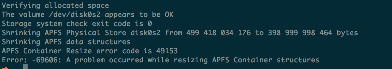

Merci pour ta réponse rapide. Malheureusement, il faut croire que ça vient pas de l'assistant bootcamp :
Shrinking APFS Physical Store disk0s2 from 129 999 998 976 to 80 000 000 000 bytes
Shrinking APFS data structures
Shrinking partition
Modifying partition map
512 bytes per physical sector
/dev/rdisk0s10: 97630912 sectors in 1525483 FAT32 clusters (32768 bytes/cluster)
bps=512 spc=64 res=32 nft=2 mid=0xf8 spt=32 hds=255 hid=156659712 drv=0x80 bsec=97654784 bspf=11918 rdcl=2 infs=1 bkbs=6
Mounting disk
1 new disk created or changed due to APFS operation
Disk from APFS operation: disk0s10
Finished APFS operation
diskutil verifyDisk disk0
Started partition map verification on disk0
Checking prerequisites
Checking the partition list
Checking the partition map size
Checking for an EFI system partition
Checking the EFI system partition's size
Checking the EFI system partition's file system
Checking the EFI system partition's folder content
Checking all HFS data partition loader spaces
Checking booter partitions
Checking Core Storage Physical Volume partitions
The partition map appears to be OK
Finished partition map verification on disk0
df -H /
df -H /
Filesystem Size Used Avail Capacity iused ifree %iused Mounted on
/dev/disk1s1 499G 368G 130G 74% 3264577 9223372036851511230 0% /
Je sèche
