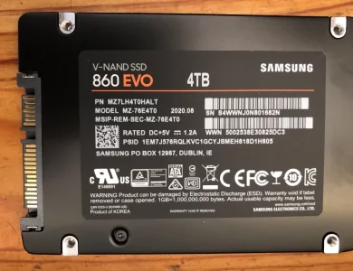

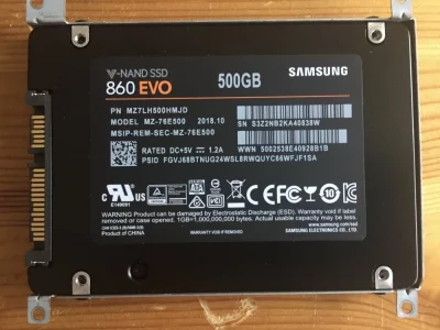

Le SSD est quasiment indispensable.

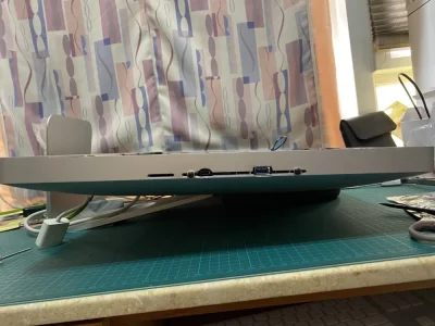

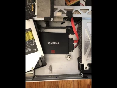

On peut mettre de l'USB 3 sur un iMac mi 2011, voir ici ;) . @Locke va être en PLS à la lecture de cette modification et des photos de l'iMac modifié ;) . Là, je serais d'accord avec lui car les découpes pour mettre les ports USB 3 , à la place du CD/DVD, sont horribles !

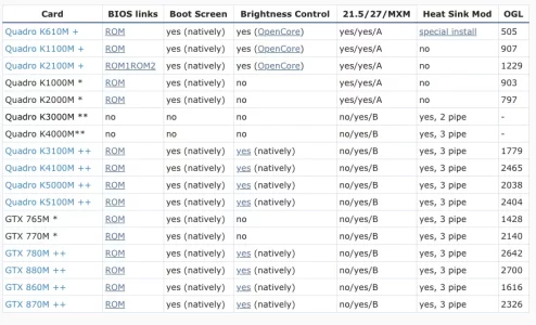

La WX4130 sans aucun doute et les spécialistes du forum macrumors conseillent les cartes AMD . Attention , la version Dell et pas la version HP.
Voila les infos importantes du forum de référence:
Pour les AMD:
  1. Most HP AMD cards will not do the POST (Power On Self Test) in the Mid 2011 models - these cards will not work!
  2. AMD WX7100 (recognized as Radeon RX 580 in macOS)
    It is important to identify the card. This card has been unpredictable. @nick [D]vB has obviously a working card with number 109-C95847-00C_02. @pascal Baillargeau has a card working with number 109-C95847-00D_02. However, other users have not been successful with the same exact models. For example, @Vego17 recently got the same card as @nick [D]vB. But his card did not work in his iMac 2011 while it does run normally in a Dell Precision 7710 laptop.
  3. AMD WX4170 (recognized as Radeon RX 560 in macOS)
    Some come with a blank EEPROM and are missing a resistor. Working models with EEPROM are scarce. User @jborko did a write up HERE on his experience installing a WX4170. You can use the 4GB version of the latest WX4150 rom too (refer to the table at the beginning).
  4. AMD WX4130/WX4150 (recognized as Radeon RX 460 or RX560 depending on used BIOS in macOS) - currently 09/10 Only
    This card needs to have an EEPROM chip on board too. There are multiple versions of this card - only the "Dell" branded versions currently work. These WX 4130/4150 are not detected in every case by the 2011 iMacs for unknown reason, and therefore are currently not fully compatible. Even worse, some models are not detected in any iMac model from late 2009 to mid 2011. A few Dell versions will be recognized and run in 2011 models. There is currently no rule available to figure out in advance which model will run. Same situations as with the WX7100.
  5. Check out below at the seven problems section for further information.
Pour les NVIDIA:
  1. Getting a 7-8 year old used Nvidia card may cause some new problems. These card may be already (half) dead after years. Do not jump into the first cheap deal, try to get unused spare parts. Most complaints on this thread (hundreds of posts) were caused by cheap old dead cards and endless trials to "repair" these by installing software. This will not work! Some Far East sellers offer new cards with new BIOS chips soldered on. Ignore those offers. We have seen also cards with unexpected small BIOS chips not capable of storing the new developed BIOS firmware versions available here.
  2. Some NVIDIA cards (K3000M, K610M, K1100M, K2100M, and K3100M) have new Hynix BFR or Elpida memory chips (late production) and the BIOS published here does not work properly in any case, you may get white screen on boot or later under load. The K3000M BIOS has been pulled back, still too many issues to solve. Take a look at the links within the tables to find your fitting BIOS. For some cards - although listed below - we may not have the correct memory versions prepared. K1100M (Elpida), K610M (Hynix) are such candidates, others may exist, too. Do bot blame the BIOS developer when getting a wrong card.
  3. Very often after installation the internal LCD remains black, only three status LED light up. You are likely hut by the black screen issue. Read the common problems and macOS installation section how to patch the problem.
  4. Check out below at the seven problems section for further information.
  5. ++ cards have a color depth problem only after boot - just sent the system once to sleep or change resolution. Alle this will cure the problem.
Bingo, tu aurais mieux fait de faire les découpes sur la face arrière à côté de celles d'origine.
hè, c'est pas mon iMac, c'est une photo d'un forum US. Je ne fais pas un boulot comme ça !!!!!

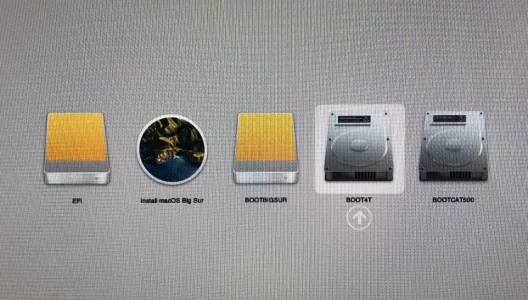

Voila ce que ça donne, lors d'un de mes essais:
  • EFI et Install Mac OS Big Sur : clef USB pour préparer l'installation avec un patcher
  • BOOT4TO: disque SSD interne principal
  • BOOTCAT500: disque SSD interne de "test"
  • BOOTBIGSUR: disque SSD en USB pour installer Big Sur (clean install)

Je vais aussi en profiter pour remplacer le DD par un SSD. As-tu des conseils sur un kit SSD spécifique à utiliser ?

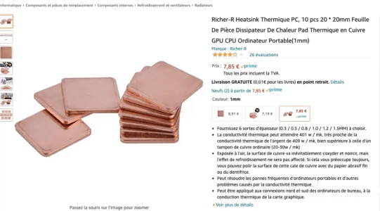

  • Est-ce qu'un coussinet thermique, comme type celui là, pourrait remplacer la plaque de cuivre ?
Non, la conductivité thermique n'est pas du tout pareille que celle du cuivre ! De plus, il est indispensable d'avoir 1 mm d'épaisseur et ces coussinets sont compressibles, donc , à mon avis, c'est à proscrire totalement pour cette modification.
Attention, il faut aussi que le morceau de cuivre soit parfaitement plan.

Sur mon iMac principal, actuellement j'ai 2 SSD internes:
- un Samsung 860 EVO de 4 To (disque principal)
- un Samsung 860 EVO 500 Go (disque de test)

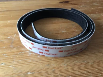

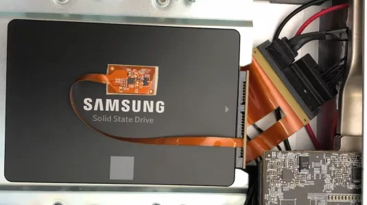

Si c'est pour les fixations:
J'avais utilisé pour les premiers changements le support original, puis un kit adaptateur 2,5 " - 3,5 " mais dans les derniers essais, j'ai utilisé du velcro , ça suffit largement vu le poids des SSD , quelques petites dizaines de grammes. Par contre, il faut utiliser un velcro de très bonne qualité, comme le Dual Lock 3M par exemple:
Voila le SSD (sous le CD/DVD):

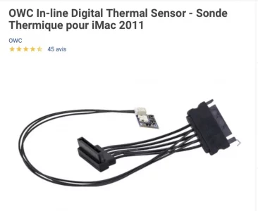

Pour remplacer le disque dur de 3,5 pouces, j'ai utilisé la sonde classique OWC dédiée au iMac mi 2011:
Avec un autre kit OWC (changement du cable SATA) , on peut avoir un deuxième SSD qui se loge sous le CD/DVD, cela permet aussi de garder le lecteur CD/DVD.

Salut a tous,
J'ai vu cela sur Amazon, si vous n'arrivez pas à en récupérer autrement , ça semble parfait, il y a plusieurs épaisseurs , il faudra simplement faire une petite découpe aux bonnes dimensions :). . L'épaisseur 1 mm devrait être OK :up:

J'ai quand même une grosse interrogation, peut être pourrez vous m'éclairer :
  • Si la WX 41x0 n'a pas le bootscreen natif (mais via OpenCore), comment faites vous pour démarrer sur la clé USB Linux avant le flashage ?
Une autre solution possible est de conserver une petite partition High Sierra (HS) qui est prise en charge nativement par l' iMac , sur laquelle l' iMac démarrera par défaut lorsque on effectue une réinitialisation de la VRAM. Il faut que cette partition soit la première et sur le premier disque s'il y a 2 disques.
Ainsi, en cas de problème et en effectuant une réinitialisation de la VRAM, on peut donc toujours revenir à HS et sélectionner le disque de démarrage dans les préférences système pour démarrer à partir d'OC sur la carte SD.
De cette façon, on peut avoir un menu de boot OC pour démarrer ensuite à partir de n'importe quel disque avec un système d'exploitation valide.
Bonsoir à tous,
Je reviens un peu à la charge concernant le remplacement de ma carte dans mon iMac 21".
A votre avis, est ce qu'une carte type gtx860m, gtx770m ou autre (en gros, une MXM B, donc un poil plus longue que les MXM A), ca passerait dans un 21" ? Je sais que les 27", il n'y a pas de soucis, mais un 21" ???
Quitte à légèrement modifier la carcasse (s'il y a une patte à faire sauter pour que ca rentre, du moment que ca reste propre...)
Merci de vos conseils avisés.

Je ne sais pas, je n'ai pas de 21 pouces et je n'ai jamais vu l'intérieur d'un 21 pouces. Sur macrumours, pour les cartes MXM B, c'est écrit no ;)
