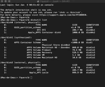

-bash-3.2# diskutil list
   2:                 Apple_APFS Container disk2         1000.0 GB  disk0s2
/dev/disk1 (disk image):
   1:                  Apple_HFS macOS Base System       2.0 GB     disk1s1
/dev/disk2 (synthesized):
   0:      APFS Container Scheme -                      +1000.0 GB  disk2
                                 Physical Store disk0s2
   1:                APFS Volume Macintosh HD - Données  868.6 GB   disk2s1
   2:                APFS Volume Preboot                 79.6 MB    disk2s2
   3:                APFS Volume Recovery                528.5 MB   disk2s3
   4:                APFS Volume VM                      1.1 MB     disk2s4
   5:                APFS Volume Macintosh HD            10.8 GB    disk2s5
/dev/disk3 (disk image):
   0:                            untitled               +10.5 MB    disk3
/dev/disk4 (disk image):
   0:                            untitled               +10.5 MB    disk4
/dev/disk5 (disk image):
/dev/disk6 (disk image):
/dev/disk7 (disk image):
/dev/disk8 (disk image):
   0:                            untitled               +2.1 MB     disk8
/dev/disk9 (disk image):
/dev/disk10 (disk image):
   0:                            untitled               +524.3 KB   disk10
/dev/disk11 (disk image):
   0:                            untitled               +12.6 MB    disk11
/dev/disk12 (disk image):
   0:                            untitled               +4.2 MB     disk12
/dev/disk13 (disk image):
/dev/disk14 (disk image):
   0:                            untitled               +2.1 MB     disk14
/dev/disk15 (disk image):
/dev/disk16 (disk image):
   0:                            untitled               +2.1 MB     disk16
/dev/disk17 (disk image):
/dev/disk18 (disk image):
   0:                            untitled               +1.0 MB     disk18
/dev/disk19 (disk image):
   0:                            untitled               +524.3 KB   disk19
/dev/disk20 (disk image):
   0:                            untitled               +6.3 MB     disk20
/dev/disk21 (disk image):
   0:                            untitled               +6.3 MB     disk21
/dev/disk22 (disk image):
   0:                            untitled               +524.3 KB   disk22
/dev/disk23 (disk image):
   0:                            untitled               +2.1 MB     disk23
-bash-3.2#
si dessus copie du résultat de la cde diskutil list depuis le terminal en mode réinstallation (Cmd+R)

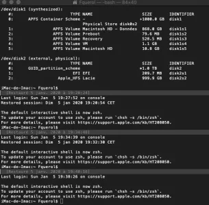

iMac-de-Imac:~ Fquerol$ diskutil ap list
APFS Container (1 found)
+-- Container disk1 D7CAD0F8-0908-480E-A138-14BD3890A320
    APFS Container Reference:     disk1
    Size (Capacity Ceiling):      999995129856 B (1000.0 GB)
    Capacity In Use By Volumes:   880395558912 B (880.4 GB) (88.0% used)
    Capacity Not Allocated:       119599570944 B (119.6 GB) (12.0% free)
    +-< Physical Store disk0s2 00004982-4BC5-0000-5950-0000B0540000
    |   APFS Physical Store Disk:   disk0s2
    |   Size:                       999995129856 B (1000.0 GB)
    +-> Volume disk1s1 3A56844C-230E-33A4-AFCA-CE4A2508509D
    |   APFS Volume Disk (Role):   disk1s1 (Data)
    |   Name:                      Macintosh HD - Données (Case-insensitive)
    |   Mount Point:               /System/Volumes/Data
    |   Capacity Consumed:         868713463808 B (868.7 GB)
    +-> Volume disk1s2 752F6E9A-503B-4252-8995-EB41ABC24F85
    |   APFS Volume Disk (Role):   disk1s2 (Preboot)
    |   Capacity Consumed:         79613952 B (79.6 MB)
    +-> Volume disk1s3 B101BC3A-6A6E-4176-A638-93BCDDAA63DB
    |   APFS Volume Disk (Role):   disk1s3 (Recovery)
    |   Capacity Consumed:         528498688 B (528.5 MB)
    +-> Volume disk1s4 541B1FB4-044A-4AEC-A346-FB6A3F5BF64A
    |   APFS Volume Disk (Role):   disk1s4 (VM)
    |   Name:                      VM (Case-insensitive)
    |   Mount Point:               /private/var/vm
    |   Capacity Consumed:         1069056 B (1.1 MB)
    +-> Volume disk1s5 9FE44E46-F4CB-43D5-B7D7-76C44368182A
        APFS Volume Disk (Role):   disk1s5 (System)
        Name:                      Macintosh HD (Case-insensitive)
        Mount Point:               /
        Capacity Consumed:         10845638656 B (10.8 GB)
        FileVault:                 No
