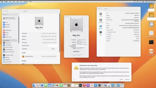

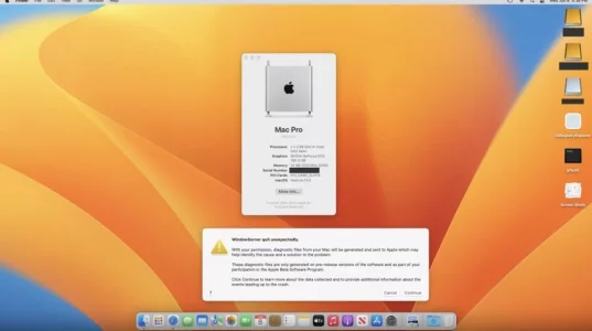

Un gars aux USA a réussi à booter un Mac Pro mi 2010 sous Ventura !!!
C'est loin d'être stable, c'est pas très simple à faire , c'est encore très expérimental mais cela montre qu'il y a de l'espoir :) . Les développeurs d'OCLP ont créé une branche Github ventura-alpha , c'est bon signe .
Voila la méthode :eek::
I'll give a brief description of the file replacement process:
- Firstly, you'll want to grab the os.dmg image from an M1 preboot volume. If you look into this image, you'll see the x86_64 caches (non-h variant).
- Copy this disk image to a USB drive in preparation for the replacement.
- Then you'll want to get Ventura "installed" onto your CMP. macOS will eventually stall at a point during the verbose portion of the first "installed" boot.
- Once macOS stalls, reboot and ensure that macOS is still stalled.
- Then you can reboot again into the recovery environment
- From the recovery, you can open up a terminal window and mount the fresh install's preboot volume (diskutil list, diskutil mount disk#s#)
- Once you get the preboot mounted, you'll want to navigate to /Volumes/Preboot/Long-UUID(check this using ls)/cryptex1/current/
- Run an ls command here, and you should see the os.dmg file
- Now run a cp command and replace the Preboot's os.dmg with the M1 os.dmg
- Once that's done, reboot your machine and Ventura should boot to either a loading bar at ~60% with a cursor or a grey screen with a beachball.
- Now you'll need to remove the Ventura drive from your cMP and install it/boot from it in another mac that is Ivy Bridge+.
This is done because the Ventura setup assistant does not play well with Non-AVX1 machines
- Once you get through the Ventura Setup assistant, remove the drive and reinstall it in your cMP
If all things go to plan, you should boot into the Ventura desktop!
Oh, that wasn't very brief
Well, good luck!
Réactions: maxou56

J'ai ajouté la description en anglais surtout pour montrer qu'il y avait de l'espoir. La personne a réussi à booter mais pas à l'utiliser quotidiennement ...
Je suis assez d'accord avec @boninmi , il est indispensable de comprendre l'anglais pour faire ce genre d'essais expérimentaux et d'avoir de bonnes bases en macOS . Ceci dit, je veux bien te traduire (ce weekend) la méthode décrite

voila une traduction rapide :), c'est simple , non ? :banghead: . Blague à part, cela nécessite de très bonne connaissance, tout n'est pas explicité ; sans ces connaissances , je déconseille;)
- récupérer le fichier image os.dmg à partir d'un volume de preboot M1 (il faut donc un mac de type M1 ....)
- copier cette image disque sur une clé USB
- lancer l'installation de Ventura sur votre mac pro
- l'installation de Ventura se bloquera à un moment donné pendant l'affichage (en mode verbose) du premier boot avec Ventura installé
- redémarrer et vérifier que l'installation de macos se bloque au bout d'un moment
- redémarrer en mode recovery
- ouvrir une fenêtre terminal
- monter le volume de pré-démarrage de la nouvelle installation (avec les commandes diskutil list, diskutil mountdisk#s#)
- se mettre dans le répertoire /Volumes/Preboot/Long-UUID/cryptex1/current (UUID avec plein de chiffres et de lettres ;))
- Exécutez une commande ls
- vous devriez voir le fichier os.dmg dans le répertoire
- remplacez le fichier os.dmg de ce répertoire par le fichier os.dmg récupéré au début
- redémarrez le mac
- Ventura devrait démarrer soit sur une barre de chargement à ~60% avec un curseur, soit sur un écran gris avec un beachball , c'est à dire la roue multicolore de macOS qui remplace le curseur lorsque l'application n'est plus en mesure d'interagir avec l'utilisateur
- retirer la clef USB de votre mac pro
- mettre la clef USB dans un autre mac qui a, au moins, un processeur Ivy Bridge+
- après l'affichage de l'assistant de configuration Ventura, retirez le clef USB
- remettre la clef USB dans votre mac pro
- si tout se passe comme prévu, vous devriez démarrer sur le bureau Ventura
