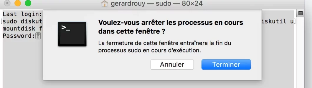

Last login: Thu Dec  7 11:29:31 on ttys000
sudo diskutil umountdisk force disk0imac-de-gerard:~ gerardrouy$ sudo diskutil umountdisk force disk0
Password:
